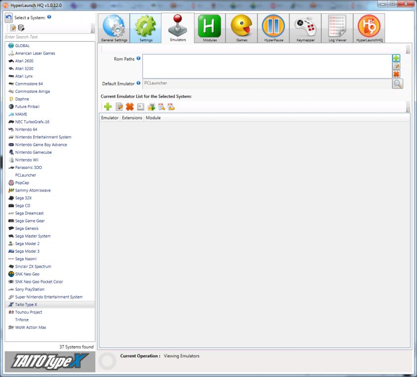

I just wanted to get clarification that Taito Type X is working fine in the New RocketLauncher...
In the PC Launcher.ini...I am pointing the script to the bat files
eg:
[super Street Fighter IV]
Application=C:\Hyperspin\Games\Taito Type X\Super Street Fighter IV\Super Street Fighter IV.bat
AppWaitExe=game.exe
I seem to be getting an issue where the game starts fine but after 20 seconds closes and the Hyperlaunch "now loading page appears"
Any help appreciated

thanks giga, nah, dont have that file. This is what I have. the files from the rom pack basically.
Hop on the ftp, my folder and grab the XB-loaders.zip.
First extract the XB-Loaders beta and then the beta 2 (overwriting when prompted) into the DB folder.
That should do it.
You can also use those for Arcana Heart 2 & 3.
The highlighted entry wont work it will need to be the bat file.
I don't think that should give you that error but change it anyway.
And have you managed to get KOF Sky Stage to work?? :) or was it added for the future?
bad try but with error
my log

thanks
when I run the game start correctly with a bat file, but when start with hyperlaunch i recive this message
12:16:04:313 | MD | ERROR | +6000 | Created missing keys for game Fill in your desired values in "C:\hyperspin\hyperlaunch\Modules\PCLauncher\PCLauncher.ini" and try again.
Is that the full troubleshooting log? Or have you cropped it? Mine is much bigger than that.

15:24:22:854 | HL |     INFO  | +0     | Main - HyperLaunch received "Taito Type X" and "King of Fighters XII, The"
15:24:22:860 | HL |     INFO  | +0     | Main - King of Fighters XII, The is using the default emulator: PCLauncher
15:24:22:862 | HL |     INFO  | +16    | Main - Checking for a [PCLauncher] section in O:\HyperLaunch\Settings\Taito Type X\Emulators.ini
15:24:22:864 | HL |     INFO  | +0     | Main - Checking for a [PCLauncher] section in O:\HyperLaunch\Settings\Global Emulators.ini
15:24:22:867 | HL |     INFO  | +0     | Main - Found [PCLauncher] in O:\HyperLaunch\Settings\Global Emulators.ini
15:24:22:869 | HL |     INFO  | +0     | CheckFile - Checking if O:\HyperLaunch\Modules\PCLauncher\PCLauncher.ahk exists
15:24:22:871 | HL |   DEBUG1  | +0     | CheckFile - Attributes:
				File Size:			20235 bytes
				Created:			7/29/2013 - 7:00:55 PM
				Modified:			7/27/2013 - 6:14:35 AM
15:24:22:874 | HL |     INFO  | +0     | Main - CRC Check - CRC matches, this is an official unedited module.
15:24:22:876 | HL |     INFO  | +0     | Main - King of Fighters XII, The will use module: O:\HyperLaunch\Modules\PCLauncher\PCLauncher.ahk
15:24:22:886 | HL |     INFO  | +16    | Main - Using SkipChecks method "Rom and Emu" or emuName = "PCLauncher".

Do you have Rom paths set here?
As you can see I don't
And what the hell is Dummy.exe? Is that something from HL2?

comparing that with mine.
toggleCursorKey = ~e & ~t
emuFullPath =
emuPath =
emuName = PCLauncher
emuExt =
romPath =
romPathFromIni =
romExtension =
romExtensionOrig =
romExtensions =
executable =
systemName = Taito Type X
dbName = King of Fighters XII, The
romName =
romMapPath =
