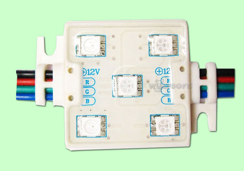

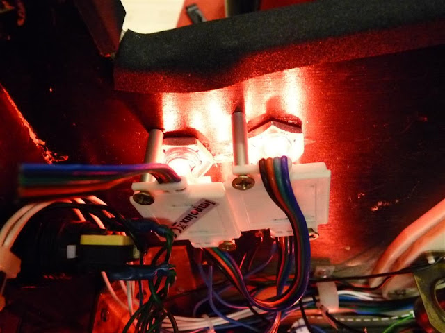

chriz99 Posted January 13, 2011 Author Posted January 13, 2011 Hey Chris, great cab, question about your flipper buttons, what LED lit ones are you using? I'm using transparent buttons with leaf springs currently. I suppose I could install some kind of lighting for them with LEDs.Wondering if you are using a ready made button solution or just lighting the transparent cabinet ones. Also, what does the lighting give you, does it just let you set the color when the game loads using the ledcontrol software, or do the ROMs actually have in game events that you can light these according to? I imagine it would be neat to have the secondary flippers light when they are active. I use RGB-LED modules for lightning my 4 flipperbuttons (to match the flipperbutton color of each dediacted pinball machine). It's just lightning without rom-controlled output. cheers chris [sIGPIC][/sIGPIC] * taito egret 29 candy cabs * indy & star wars pachinkos 17" bartop with ledwiz rgbleds * 10" bubble bobble & galaga bartop * arm champs 2 check out hi-res backglasses * best vpin performance * ledwiz config and software
granter Posted January 13, 2011 Posted January 13, 2011 I use RGB-LED modules for lightning my 4 flipperbuttons (to match the flipperbutton color of each dediacted pinball machine). It's just lightning without rom-controlled output. Cool thanks for the info, so those are just transparent buttons with leaf switches probably like mine then, with those LED modules behind them? Hard to tell about the buttons from the pic, I get the LED part, but the buttons are they just leaf switches and translucent buttons?
chriz99 Posted January 13, 2011 Author Posted January 13, 2011 yes, I use transparent pinball buttons with original pinball leaf switches (for the right feeling). cheers chris [sIGPIC][/sIGPIC] * taito egret 29 candy cabs * indy & star wars pachinkos 17" bartop with ledwiz rgbleds * 10" bubble bobble & galaga bartop * arm champs 2 check out hi-res backglasses * best vpin performance * ledwiz config and software

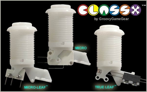

shilmover Posted January 13, 2011 Posted January 13, 2011 I use these. They are not perfect as they are frosted, rather than transparent, but I really like the leaf button feel for the flippers (the one on the right): http://groovygamegear.com/webstore/index.php?main_page=product_info&cPath=73&products_id=238
granter Posted January 13, 2011 Posted January 13, 2011 Those look pretty cool, I like that you probably wouldn't have to adjust them as much as normal leaf springs or play around with the mounting.

hicks100 Posted January 13, 2011 Posted January 13, 2011 maplins are not much good lettuce. I ended up using ebay, theres alot more choice on there. And re the buttons i used the Groovy Game Gear buttons also and they were good enough to include the new Pro-Leaf switches for the same as the true leafs. Not sure if there even on the site yet but they work a treat.
