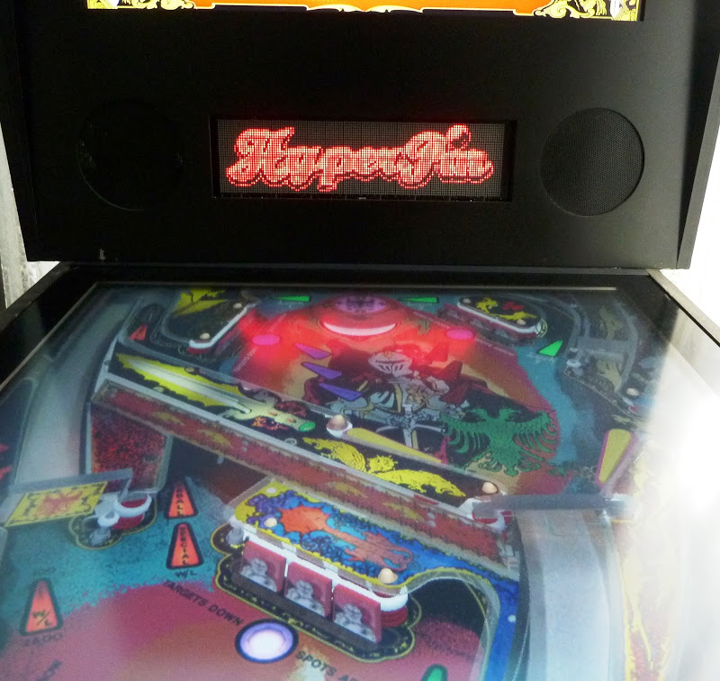

maxxsinner Posted February 28, 2012 Posted February 28, 2012 Russ has sent me some new firmware with the HP logo on it (with BBB's permission of course). Instructions were are breaze to follow and its great to not having a blank DMD when scrolling through tables. Awesome finishing touch Russ! Electropin - Enough lights to land a jet on an aircraft carrierHigh Voltage Pinball - Cause one build just wasn't enough Voltek Arcade - Funglo pedestal style mame cabinet Pinball Electrical Tutorial - Wire All Your Bling With Confidence and Fewer House Fires

russdx Posted March 4, 2012 Posted March 4, 2012 iv made it so the logo is now stored in a .txt file you place in your tables folder no firmware upgrading needed pinmame.dll will look for that txt file in between games and use that as the logo also looking into having the dmd scroll through table names / manu logos
