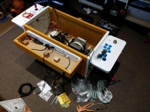

juicelee Posted October 19, 2016 Posted October 19, 2016 looks phat mate. what is the other little screen for ? keep up the good work thanks for sharing
thatman84 Posted October 19, 2016 Posted October 19, 2016 Well that is looking a bit special I think your fixing idea is probably the most straight forward for invisible fixing. Maybe glue another block to the under side to stop them sliding towards the player Hyperspin 2.0 Latest Download Hyperspin 2.0 Documentation -------Pre Hyperspin 2.0 Below---------- HS Android Overview & Install HS Android Base Pack Download My Tutorials
gigapig Posted October 19, 2016 Author Posted October 19, 2016 Thank you gentlemen. Juicy. The second screen will hopefully either display Marquees, hi scores and pinball DMD. That's the plan in my head anyway.

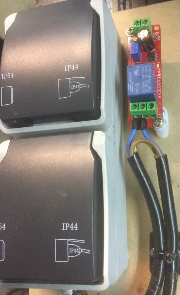

Gerurver Posted October 20, 2016 Posted October 20, 2016 Hi Giga, whats your wish with the power outlet? I use a 5v relais switch with adjustable time. So when you turn on the pc. The timer (example) is waiting 15 seconds(so you dont see the bios) and then turns on the power. For the Big and little screen and external fan. When you shut down hyperspin, iT closes the pc, so the relais is not getting 5volt. So the power will cut of all the power. Hope you understand my bad english. ;-) Its the little red box. For holding your cp. Because its perspex(plastic) Some iron glue under iT. And a magnet in the box(wood) Greets Ger

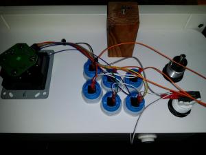

gigapig Posted October 21, 2016 Author Posted October 21, 2016 Here's my solution for fixing the perspex panels in place, the threaded bolt passes through the base of the CP and then has a nut on it which I could swap for a wing nut. The wood was the cabinets original legs.

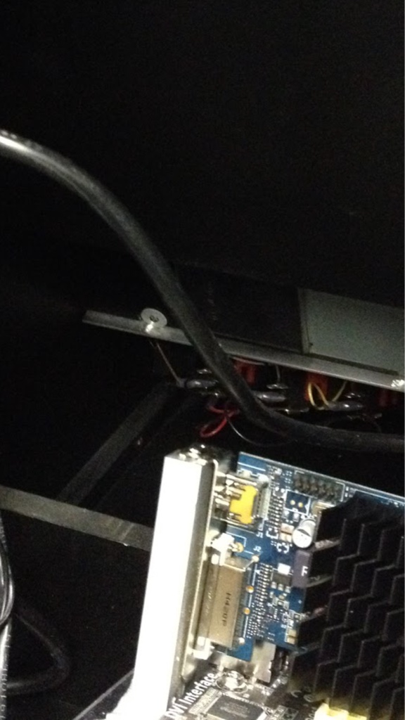

gigapig Posted October 26, 2016 Author Posted October 26, 2016 Chaos. Nearly ready for the big switch on. One final problem I have is how to secure the GPU as there is no case to screw it too. I know it will be OK as it is but it does wobble a bit.
THK Posted October 26, 2016 Posted October 26, 2016 Nice, I recognize that humongous CPU cooler ..........................back with a vengeance........................
Gerurver Posted October 26, 2016 Posted October 26, 2016 Hai Giga. I use a square aluminium piece. On top and under a hole with a stud. Bolt on top(gpu) holding tight. And under a bolt by the wood into the aluminium piece. Sorry for the bad english;-) Cheers Ger,
gigapig Posted October 26, 2016 Author Posted October 26, 2016 Hai Giga. I use a square aluminium piece. On top and under a hole with a stud. Bolt on top(gpu) holding tight. And under a bolt by the wood into the aluminium piece. Sorry for the bad english;-) Cheers Ger, Awesome Groove, thank you. No need to apologise for your English it's better than mine.
