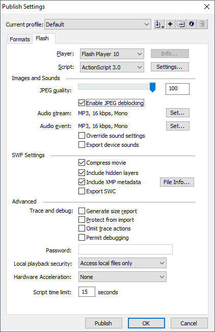

Retro Goonie Posted July 16, 2017 Posted July 16, 2017 @Avar Hey mate! I finally bit the bullet and got hold of Adobe Flash. I followed your tutorial on YouTube and using dark13 "smooth" script, managed to convert a theme into flash and looking smooth! No jaggies! However I have encountered a problem! In Hypertheme I had set certain artworks to appear using the "blur" animation. After converting the artworks to flash, this "blur" effect has changed to more of a fade. It is still labeled as "blur" in the themes .xml but just doesn't behave the same anymore?! I had a quick try at re-opening the theme within Hypertheme but after the conversion to flash, Hypertheme doesn't seem to be able to open the theme anymore?! Any ideas? Has anything like this happened to you before? My Artwork! Carts: GCE Vectrex 2D Carts (Realistic Version) 1.0, GCE Vectrex 2D Carts (Vector Version) 1.0 Pointers: NEC PC Engine Pointer(s), NEC SuperGrafx Pointer(s), Sega SG-1000 Pointer(s), Sega TecToy Pointer(s), Sega Mega Drive Japan Pointer(s), Nintendo 64 Pointer(s)
Avar Posted July 16, 2017 Author Posted July 16, 2017 Certain animations don't work with SWF unless they're converted to flash animations. I wouldn't sweat it as themes are changing dramatically soon. 1

zillion23 Posted August 5, 2017 Posted August 5, 2017 I got the resizing of the png files down but I was wondering if you could go more in depth on how to resize a swf file down to 75% to get a proper 16:9 ratio?
thatman84 Posted August 5, 2017 Posted August 5, 2017 2 hours ago, kmoney2315 said: I got the resizing of the png files down but I was wondering if you could go more in depth on how to resize a swf file down to 75% to get a proper 16:9 ratio? Someone with more skills will need to input but i think the display size is setup in the settings when you code/create swf stuff with after effects. There are a bunch of swf conversion scripts by @dark13 in the artwork or theme creation forums. Have a search through there. Also there has been talk that swf may be redundent soon. But soon is anyones guess. Could be years Hyperspin 2.0 Latest Download Hyperspin 2.0 Documentation -------Pre Hyperspin 2.0 Below---------- HS Android Overview & Install HS Android Base Pack Download My Tutorials
zillion23 Posted August 5, 2017 Posted August 5, 2017 I know about the scripts and use them regularly but all those scripts are for converting png files to swf files. I would like to know the best way for converting a swf file in a existing theme into the proper ratio with 16:9 ratio like the scripts do for the png files.
Bungles Posted August 6, 2017 Posted August 6, 2017 I was taught by my mum, never try and convert backwards. (Hence the reason lots of people plea to keep the media used handy... I think.) Not sure if it will work out that well as you are going to expand something to shrink something.. to have it expand again. (My head hurts) However if the scripts convert at a .533 on the x and .711 on the y. You could reverse engineer the ratios perhaps. So you set the X to be (** x 1.875) or 187% and the Y to (** x 1.406) or 140% Unless my math is way off in which case back to schoool. Retro Cafe - Universal ThemeHyperControl - Main Menu Config and Apps WheelAudiocade - Main Menu Music PlayerTelltale Games WheelPCGamers Top 100 PC Games 2014 WheelMGS HD Exit Screen8-Bitdo Special ArtAll Contributions My Youtube Channel - https://www.youtube.com/user/3ungle

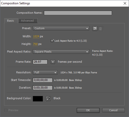

Bungles Posted August 6, 2017 Posted August 6, 2017 Sorry.. I thought about it for a moment longer.. and yeah, Back to school for Bungles. 4:3 converted to 16:9 at a full screen level will result in loss of image or black lines or stretching (No way around this I don't think). But for other images/other media the below should work. If you have Adobe After Effects you should be able to do it the same way I do with my background videos. (However not sure on quality loss at this stage.) Method: 1. Start After Effects and create a 1024x768 composition. (Settings below) 2. Import the swf you want to convert and drag it into the middle of your composition. // Scale the image/import from 1080p to 1024*768 and apply 16:9 ratio correction. (Need to right click and goto Transform -> Scale then un-link the aspect ratios and set manually to the below) X = 53.33% Y = 71.11% 4. Arrange the Image to where you want in the theme. Then click file, export to Flash (Fxl Extention) 5. Open Fxl File in flash, and publish it again to swf action script 3. (Settings below) Might just work.. but might be quicker in some cases to just try and re-source the original png/vector arts. Retro Cafe - Universal ThemeHyperControl - Main Menu Config and Apps WheelAudiocade - Main Menu Music PlayerTelltale Games WheelPCGamers Top 100 PC Games 2014 WheelMGS HD Exit Screen8-Bitdo Special ArtAll Contributions My Youtube Channel - https://www.youtube.com/user/3ungle
