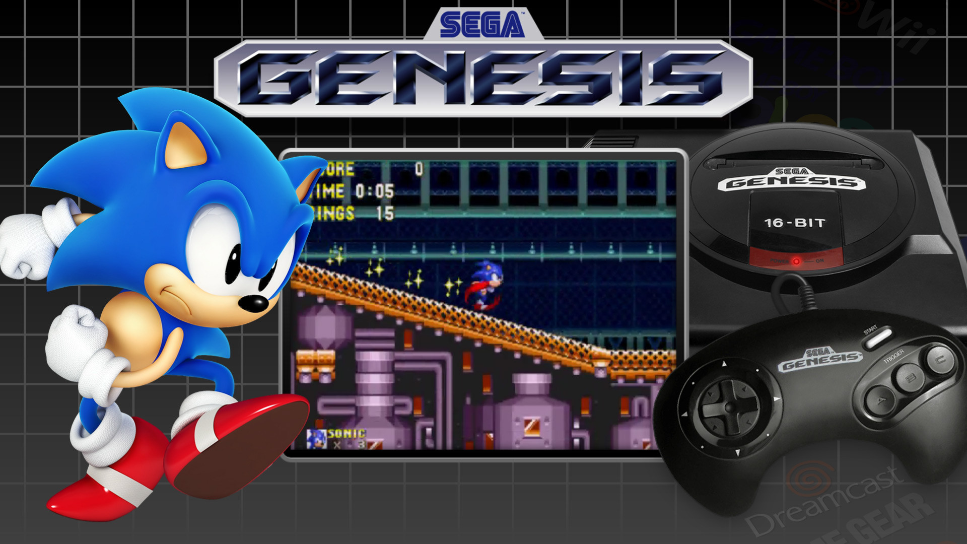

gibbawho Posted January 19, 2014 Author Posted January 19, 2014 So ... I've got something awesome to share with you guys. I was messing around with animated backgrounds using images imported into flash for the ATARI themes I'm working on and I realized something interesting. Flash basically procedurally renders images on the canvas. This allows you to resize images inside of flash easily. It dawned on me that if I import artwork I've exported from a full 1080p PSD, then figure out what each Artwork's size would be at 1365x768, then make my flash canvas that size .. import the 1080p asset into that canvas and size it down in flash... then save that as a flash artwork asset in the theme... ...the end result is none other than FULL 1080p themes with 0 loss of resolution! I don't know if i'm the first one to discover this but it totally works. This image is a screenshot from hyperspin, not a psd. Notice how crisp it is. The only artwork not high res is the video border. AND THIS ISN'T EVEN WITH OPTIMAL ARTWORK FOR THE RESOLUTION! But you can particularly notice the quality on Sonic's gloves. Combined with the vector background i think it cam out pretty awesome. What's even cooler is flash compresses by itself so in many cases these themes will actually be SMALLER than their standard res counterparts. Only downside is it takes a pretty beefy system to run them smoothly and it takes much more time to make themes this way. You can find my prototype featured in the screenshot in my ftp in /working/HD Check it out and let me know what you think!
gibbawho Posted January 19, 2014 Author Posted January 19, 2014 Oh yeah.. the widescreen resizing is done in flash as well so i can keep the actual image assets in proper aspect.
guyverjay Posted January 19, 2014 Posted January 19, 2014 Just tested it, its very sharp indeed. If we had a set like this, I'd crap my pants

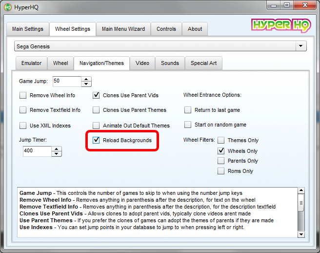

boohiss Posted January 20, 2014 Posted January 20, 2014 Looking good! Quick question though. Is there any way to make the animated background (such as the scrolling grid for Genesis) continue to scroll after you switch to a different game? As soon as you touch the wheel from the first game selected, the animation stops. I notice in the first post it doesn't stop at all, but using the release files you have on the FTP, I encounter the stopping.
gibbawho Posted January 20, 2014 Author Posted January 20, 2014 Is there any way to make the animated background (such as the scrolling grid for Genesis) continue to scroll after you switch to a different game? The answer is an unequivocal "sort of". There's a per system setting in HyperHQ. It reloads the background and restarts the animation each time a game is selected. See the following screenshot:

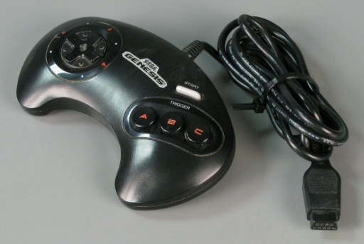

DamnedRegistrations Posted January 20, 2014 Posted January 20, 2014 That is indeed a fantastic find, if only it were easier accomplished. The only problem with your Gen theme is that's not the original controller that came with the first console which you used. You wouldn't even need a new scan and could just tweak it yourself but this is how the original controllers looked (burgundy button text/directions): If needed, I could try to stick a controller in my scanner or take a high-res pic of one that will just require a pen cut. I still have most of my old consoles and accessories.
jaZz_KCS Posted January 20, 2014 Posted January 20, 2014 Colouring the directional arrows and button labels into burgundy should not be a hard task, since he definitely still has the individual layers ready I would assume.
