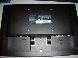

arngrim Posted July 9, 2011 Posted July 9, 2011 thanks ep!decased my 15.6" widescreen lcd today. fits just perfectly on a standard speakerpanel. will paint the bezel black matte. Hello Chris, By chance, a shop near my home sell the same screen that yours. I'm trying to "strip" him but I don't really know how to do it, I'm a newbie for this. I have removed the 4 screws at the bottom of the back of the screen, like the screenshot. This may be sound stupid, it's surely a piece of cake for all of you but I don't know what to do next to make it naked At the bottom right of my image, there's a hole with a lock, do I have to do somhing with this?
chriz99 Posted July 9, 2011 Author Posted July 9, 2011 this screen is just clipped. maybe a piece of plastic or a screwdriver will help. cheers chris [sIGPIC][/sIGPIC] * taito egret 29 candy cabs * indy & star wars pachinkos 17" bartop with ledwiz rgbleds * 10" bubble bobble & galaga bartop * arm champs 2 check out hi-res backglasses * best vpin performance * ledwiz config and software
arngrim Posted July 9, 2011 Posted July 9, 2011 OK, I put a little bit more strength and it worked, I was scared to damage the screen. Thanks Chris

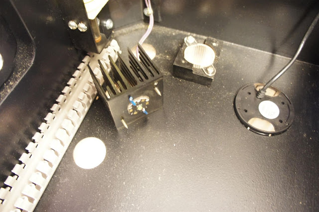

Numiah Posted July 10, 2011 Posted July 10, 2011 Aha ! Now I finally see how you mounted those underside lenses ! They're just standard caps. Really inventive sir. **Each pinball machine is a tiny universe... that we control** My Build Overview My Computer Specifications
chriz99 Posted July 10, 2011 Author Posted July 10, 2011 yes, just a standard flasher cap, here is a better pic for you cheers chris [sIGPIC][/sIGPIC] * taito egret 29 candy cabs * indy & star wars pachinkos 17" bartop with ledwiz rgbleds * 10" bubble bobble & galaga bartop * arm champs 2 check out hi-res backglasses * best vpin performance * ledwiz config and software
maxxsinner Posted July 10, 2011 Posted July 10, 2011 How have you got them connected Chris? Are they connected to one of your top flasher so they go off at the same time or have you and your fellow geniuses work out a way to use 2 LEDwiz's? Electropin - Enough lights to land a jet on an aircraft carrierHigh Voltage Pinball - Cause one build just wasn't enough Voltek Arcade - Funglo pedestal style mame cabinet Pinball Electrical Tutorial - Wire All Your Bling With Confidence and Fewer House Fires
chriz99 Posted July 10, 2011 Author Posted July 10, 2011 connected them to the top flasher. 2x underside and 4x backbox, wired 2x 3 in a series (so i can power them with 12vcd via a mini constant current power board) cheers chris [sIGPIC][/sIGPIC] * taito egret 29 candy cabs * indy & star wars pachinkos 17" bartop with ledwiz rgbleds * 10" bubble bobble & galaga bartop * arm champs 2 check out hi-res backglasses * best vpin performance * ledwiz config and software
