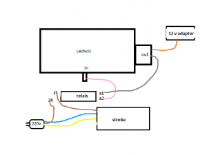

mistermixer Posted February 25, 2011 Posted February 25, 2011 Link : it's a belgian online shop. I went over there to get my strobe. You'll have to add shippingcosts. http://www.partysoundandlight.be/ mail to: [email protected] tell him you saw this add and want one for that price :-) http://nl.kapaza.be/vi/50145795.htm
Numiah Posted February 25, 2011 Posted February 25, 2011 lol @ the vultures picture **Each pinball machine is a tiny universe... that we control** My Build Overview My Computer Specifications
lettuce Posted February 25, 2011 Posted February 25, 2011 Link : it's a belgian online shop. I went over there to get my strobe. You'll have to add shippingcosts. http://www.partysoundandlight.be/ mail to: [email protected] tell him you saw this add and want one for that price :-) http://nl.kapaza.be/vi/50145795.htm So how do we go about wiring these strobes up, does it have its own 12v lead with plug attached?? Also that link lists the strobe as 130 euros??
thewool Posted February 25, 2011 Posted February 25, 2011 Hi Lettuce. Here's one for us UK folks, £59.99 posted: http://cgi.ebay.co.uk/Wildzap-1500-Watt-DJ-Disco-Club-Strobe-Very-Bright-/270597680706?pt=UK_ConElec_LightingLEDsStrobes_RL&hash=item3f00e0ee42 Spec: Product Information Bright 1500 Watt strobe with adjustable flash rate (from 1-15 flashes per second), adjustable intensity up to 100%. Linkable to other Wildzap units and controllable from most pulse strobe controllers. Features: Adjustable flash rate Adjustable intensity rate 0 - 100% Dimmable 1 - 15 flashes per second Specification: Power supply: 240v Lamp: SOB 1500w Dimensions: 455 x 155 x 127mm ( without bracket ) Weight: 6.4kgs edit: just need to make sure it can be wired in w/o a controller
mistermixer Posted February 25, 2011 Posted February 25, 2011 see the last link : http://nl.kapaza.be/vi/50145795.htm the strobe on the website is a dmx controlled one,we only need a cheaper analog strobe

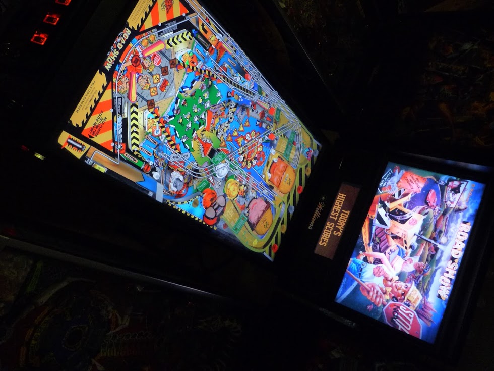

chriz99 Posted February 27, 2011 Author Posted February 27, 2011 one of my new favorite tables: and a curious place for a ball cheers chris [sIGPIC][/sIGPIC] * taito egret 29 candy cabs * indy & star wars pachinkos 17" bartop with ledwiz rgbleds * 10" bubble bobble & galaga bartop * arm champs 2 check out hi-res backglasses * best vpin performance * ledwiz config and software

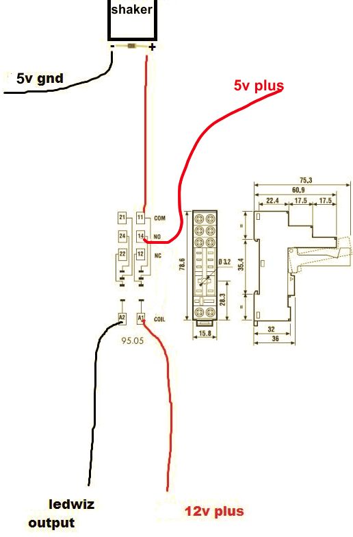

lettuce Posted March 5, 2011 Posted March 5, 2011 So now we dont need the relay for the shaker motor anymore how do we wire the shakermotor up now, just the positive to 5+ and the negative to the ipac?? just 2 wires?
Numiah Posted March 5, 2011 Posted March 5, 2011 You most definitely need a relais as the picture suggests. In the picture you can see your ledwiz is only powering the coil of the relais and the motor has its own 5V supply. Ledwiz provides 500mA max, without a relais you'll fry your wiz. **Each pinball machine is a tiny universe... that we control** My Build Overview My Computer Specifications
lettuce Posted March 5, 2011 Posted March 5, 2011 Thanks for the reply, so the replay needs both a 12v and 5v if i want the shaker to be power by 5v
lettuce Posted March 6, 2011 Posted March 6, 2011 So for the diagram below i would remove the 12 volt wire altogether and place the 5 volt wire there instead?
Numiah Posted March 6, 2011 Posted March 6, 2011 That would be possible if the relais doesn't need 12v to make it switch. What relais are you using ? If it say's 12v on the side, you'll need 12v to the coil of the relais to make it switch on and off. (which is most likely the case) The 5v is the cable that gets switched on-off and is purely there to power the shaker when the relais is switched to "on". So you need to see these two things completely separate. A switch(powered by 12v) and the switched switching 5v on and off. Maybe this video can shed some light : JkG22KgciwY Hope it makes sense **Each pinball machine is a tiny universe... that we control** My Build Overview My Computer Specifications
lettuce Posted March 7, 2011 Posted March 7, 2011 Hmm, maybe i should of used this diagram to wire the shaker motor????
