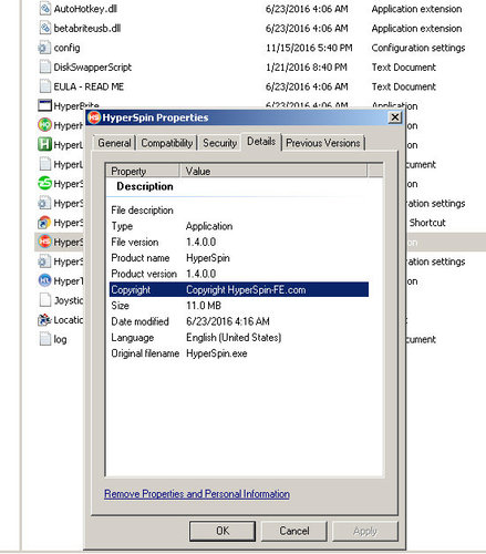

thomas3120 Posted October 8, 2019 Posted October 8, 2019 To see your current version of Hyperspin can you right click hyperspin.exe/propereties/details? t **Yow.. appears so, was running an old vers (1.4).. Got it updated
